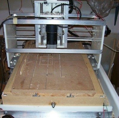

      I've built 2 at this point. As I've mentioned in a couple of threads, John Kleinbauer has some nice plans at around 35 dollars. He is at crankorgan.com. I first made one from his plans and then moved on to a machine of my own design that was large enough to rout bodies and necks. I purchased a motor/controller system to avoid problems in that area. You can probably get a machine up and running for 300 dollars or so.

PostPosted: Tue Jun 27, 2006 9:45 pm
Joined: Fri Mar 31, 2006 9:42 pm
Posts: 79
Here is a picture of it.
